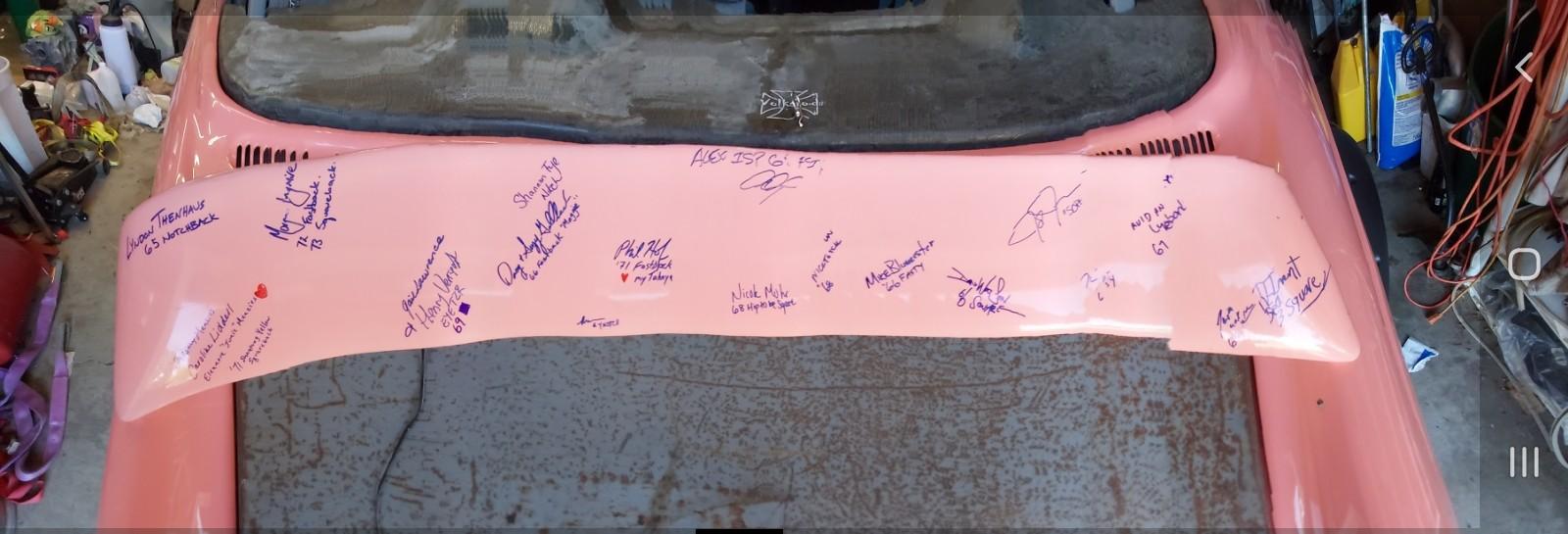

Post by vwfye » 24th June 2022 - 5:58am
20th anniversary, so I brought a piece from the 1st event to have signed. Priceless to me.
