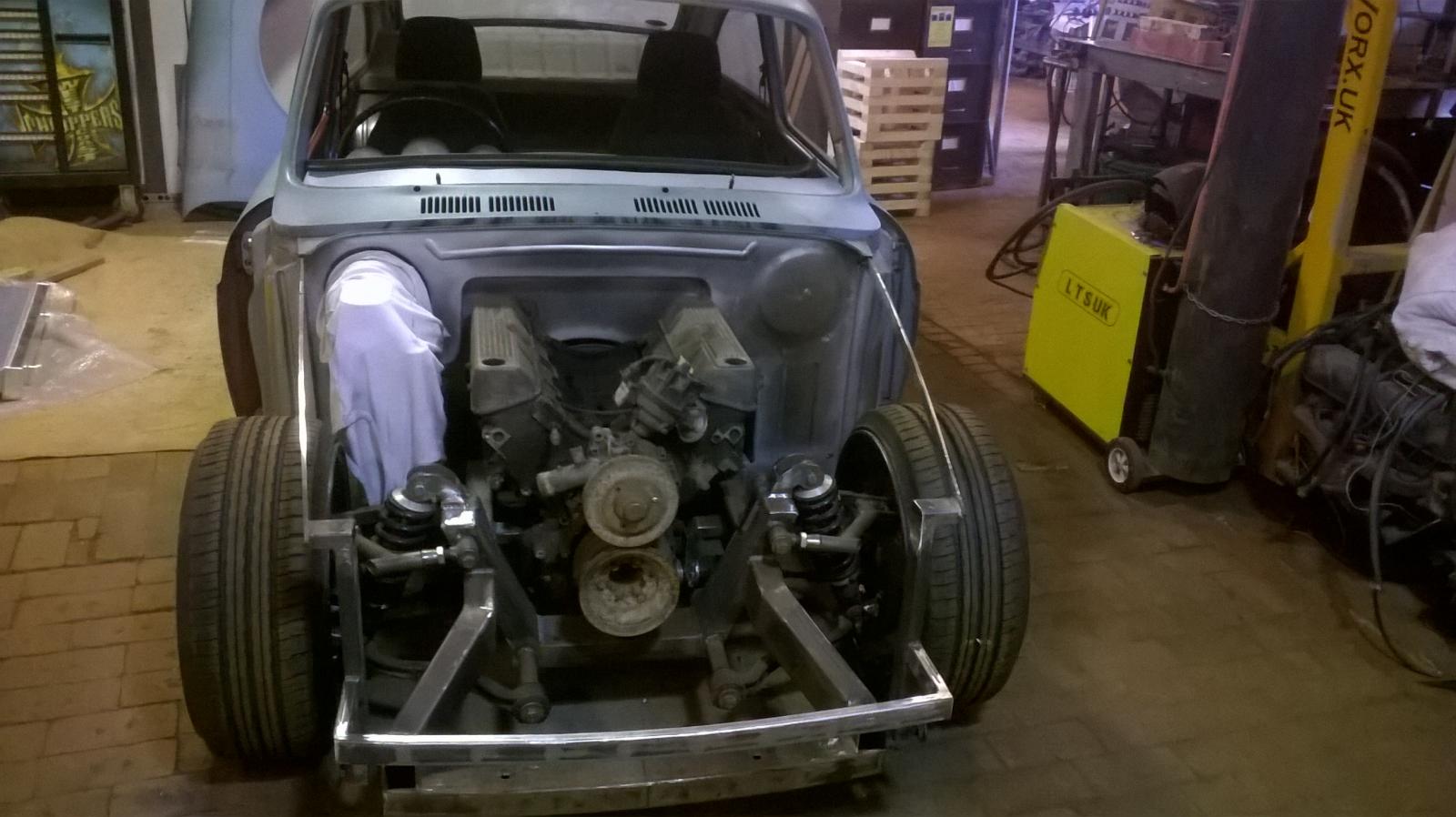

got all the steering parts bolted on so i put the fastty back on the floor to add some weight to make sure it all worked as it should, in doing so the front end panels all had to come off so i got some pics of it all apart.
one good thing with keep stripping it down is that you know it all fits as it should.

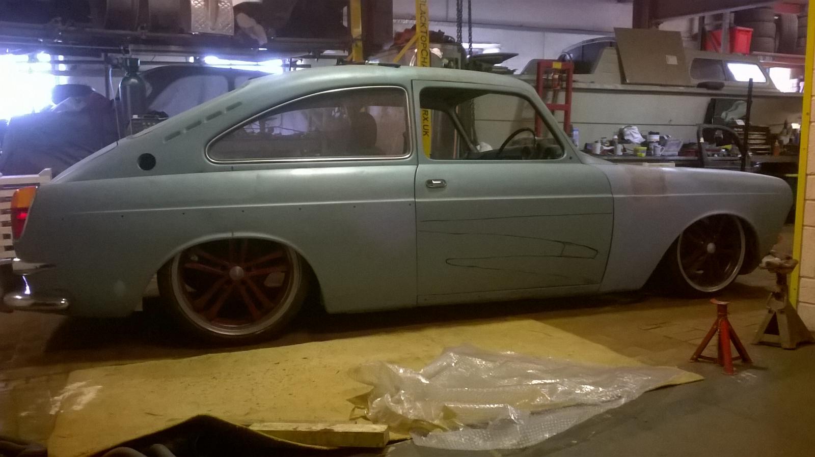

finally got some stuff done, finished up the other door handle and started to extend the bonnet. todays mission was to blow the body apart and take it of the chassis.
really happy how the floors look, all most factory. ahh ahh

made some reel progress this week, got the front hubs redrilled and the suspension back on. got the adaptor done to mount the mazda rx8 gearbox onto the rover engine and got it bolted back in the chassis. with the engine back in next thing was to fit all the exhaust system. everything seems to fit as it should so happy days.
