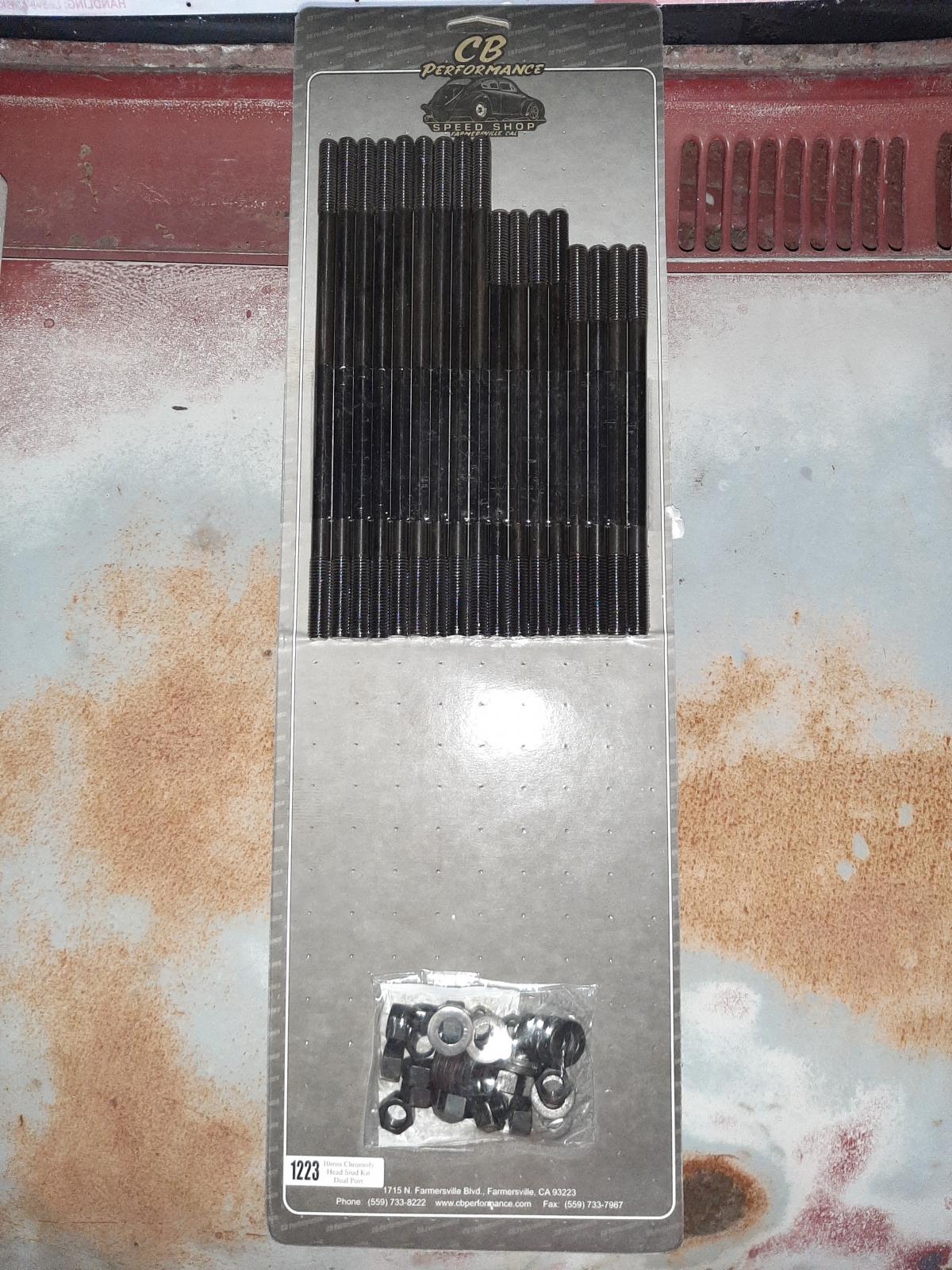

Case studs are out. Next... clean again and reinstall the case savers that came out with the studes. New CBPerformance mil-spec studs go in!
