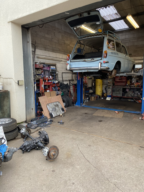

Hmm, sounds a bit like a FWD car that is on the ramp in full droop with gears engaged. The angle for the CV is excessive and it locks / releases as it rotates. That or the diff locking up / releasing.
Does it bang / make noises when freewheeling ?
David

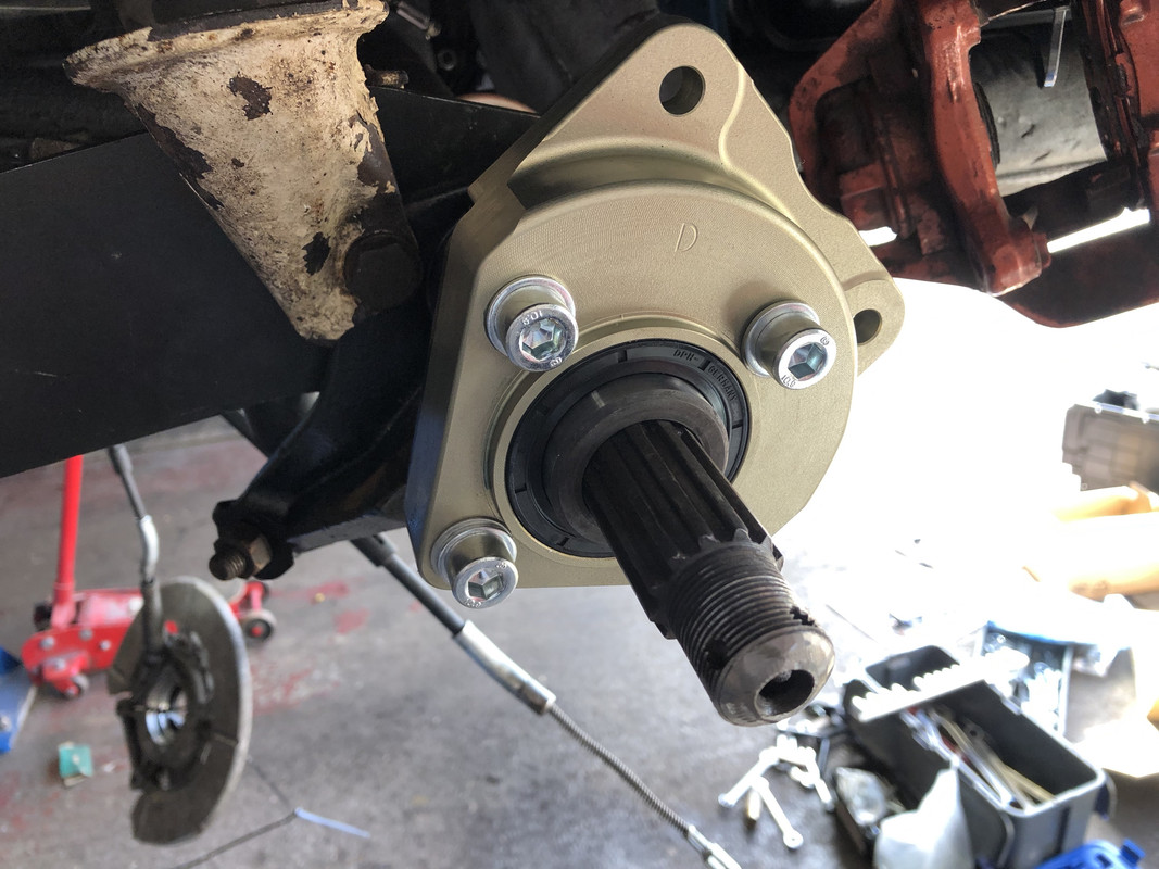

Update: gearbox has been left for a full strip and rebuild, but no fault has been admitted.

The transmission is back in the car, just needs to be fitted now.

You had me confused for a moment there, until the picture appeared.
Is there any diagnosis shared ?
David
1974 412LS Variant
1973 412LE 4 door Fastback / Saloon
User avatar
sparkywig
Posts: 544
Joined: 28th August 2013 - 12:49pm
Re: '67 Square continued.....
Post by sparkywig » 21st January 2020 - 7:42pm
Replacement fulcrum plates and side gears apparently.
No fault admitted, but only charged me £40.

I didn't know what they were so had to go searching on Samba. There's a few threads on there - seen this ?

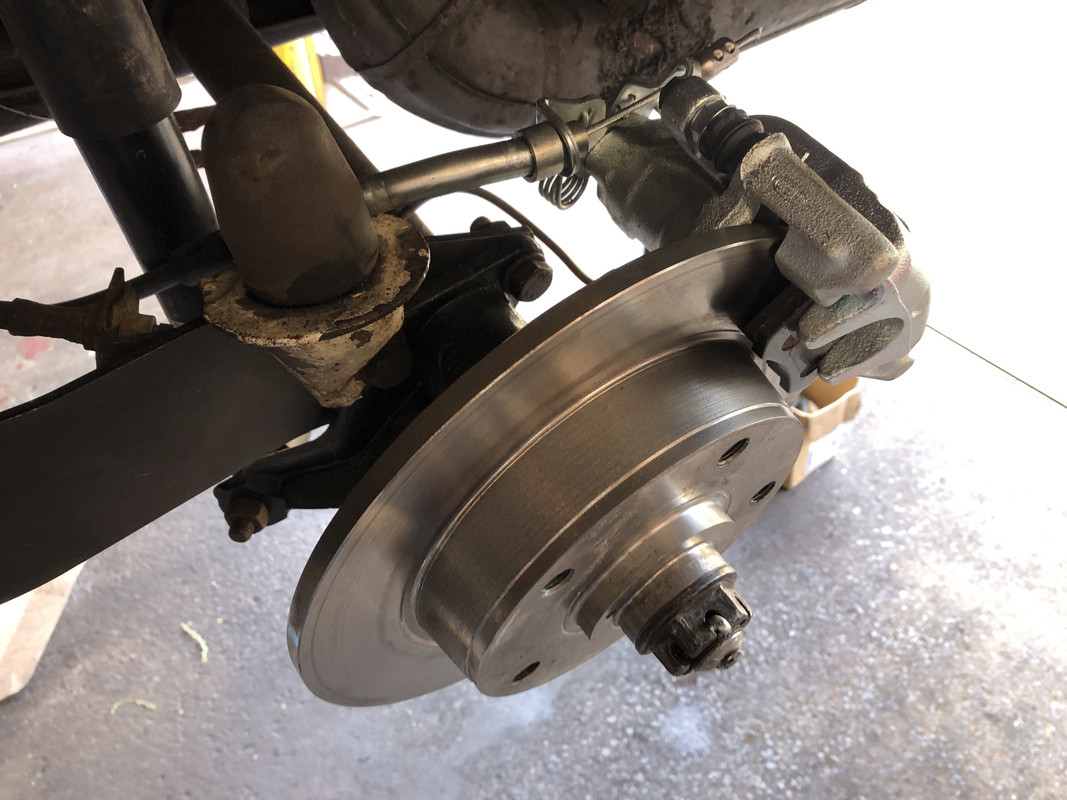

At the risk of being a numpty...... why is there an "L" for left on the right hand brake disc ?
David
1974 412LS Variant
User avatar
sparkywig
Posts: 544
Post by sparkywig » 22nd January 2020 - 9:43am
I presume it was marked by the rebuilder before disassembly.
User avatar
937carrera
Posts: 1082
Joined: 7th June 2013 - 11:54pm
Location: North Yorkshire
Post by 937carrera » 22nd January 2020 - 10:46pm
So it was worth marking as being from the left but not worth reassembling in that same position.
I'm sure it's fine, just a bit strange and confusing for me
David
1974 412LS Variant
User avatar
sparkywig
Posts: 544
Post by sparkywig » 22nd January 2020 - 11:25pm
I'm sure it was on his left

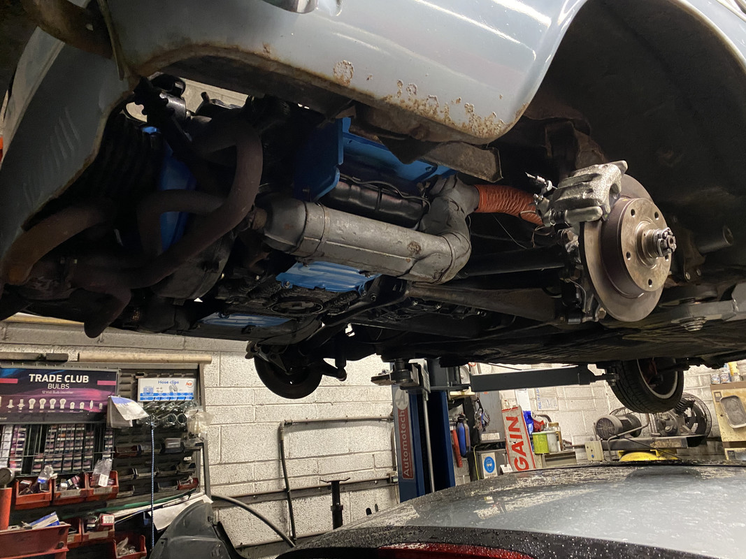

So then here we go again
Off down the M32
On the ramp
You were right to be concerned @937carrera, note the position of the calipers and carriers in relation to the gearbox in the previous and following pics.
New master cylinder fitted as well, and the brakes are much better, just need the new discs and pads to bed in.
After the test drive
And back home in the storm under it's own power.
Really need to connect the heat exchanger cables.....
Just one small issue to sort, the brake pedal pushrod needs to be backed off as the brakes were binding, and the higher 4th and final drive really do need a bigger engine. :lol:

The new bearing caps and carrier mounts were refitted 90 degrees out, and at opposite ends.
20 minutes and it was sorted.
Once the weather has improved I'll dry the car out, readjust the brake pushrod and put some miles on it before I decide what I'm going to do.
Although most of that will be done in 3rd gear. :lol:
