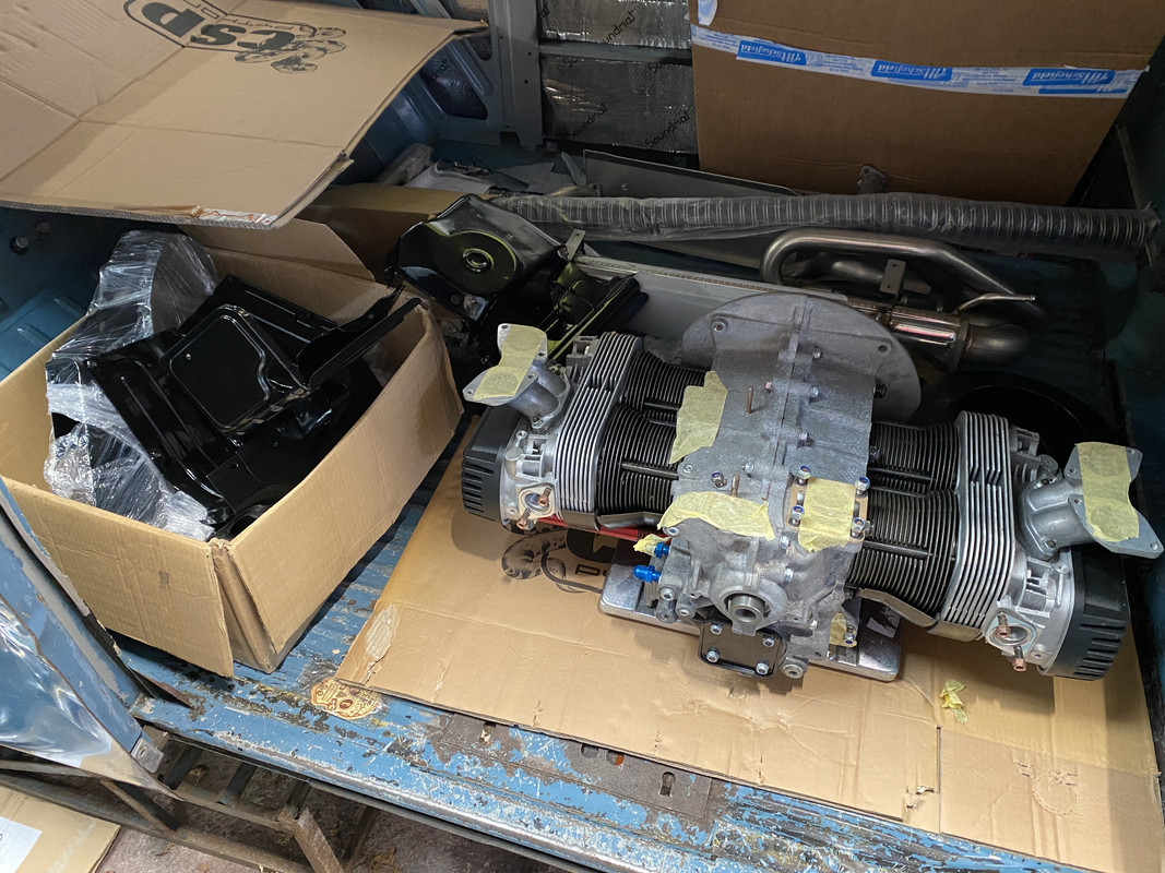

As I was picking the squareback's new engine up from Suffolk yesterday, I had a socially distant parts run around Central England collecting a host of other goodies.

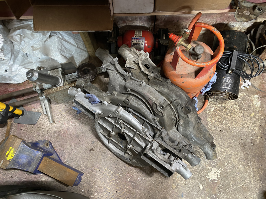

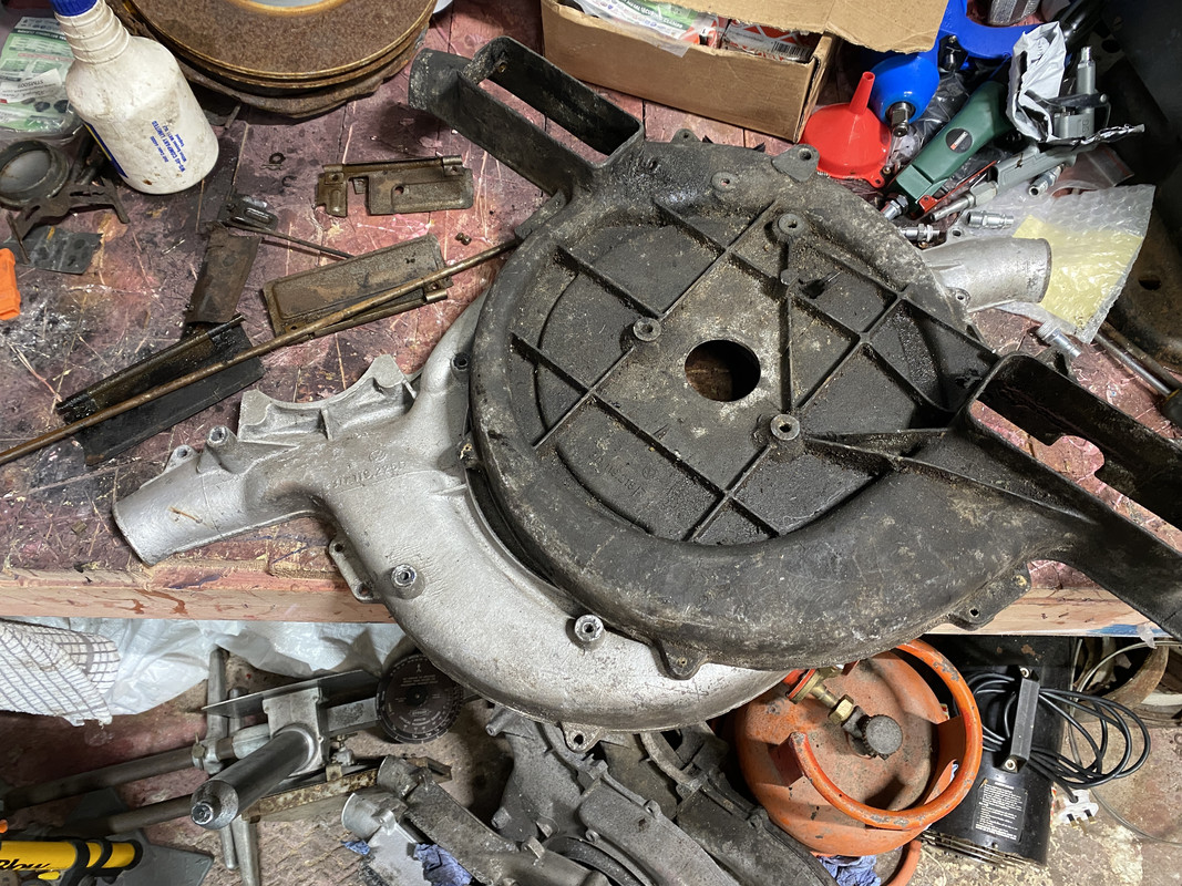

Checked and stripped a number of fan housings to get a good pair and a set of working flaps. These will go for media blasting and a clearcoat.
And the rest are scrap.

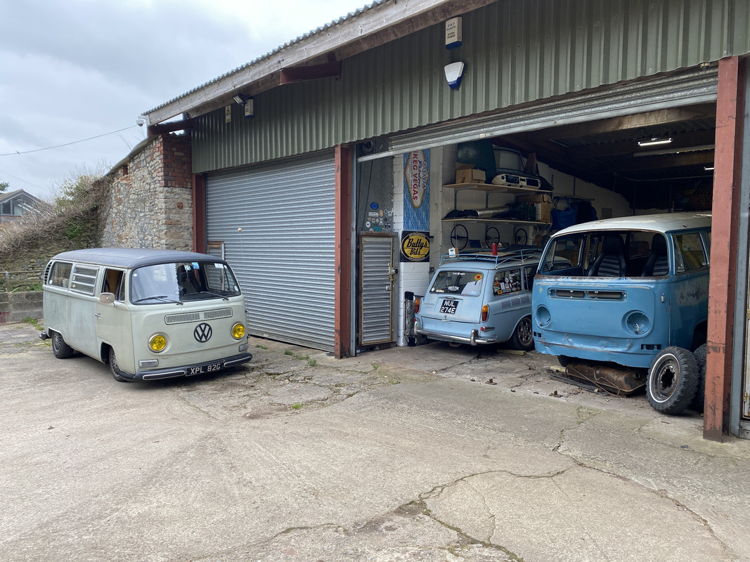

Took a drive in the bus the long way round to the lockup.

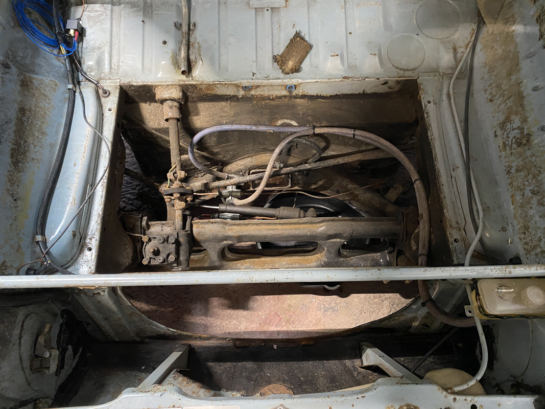

Out with the tank, which was surprisingly easy. I can also tidy the low pressure brake pipes and clean up the normally hidden area under the tank now as well.
Oh, looks like the fuel pipe needs renewing anyway.
I'll need to fabricate a bracket for the fuel pump, any idea what stock FI cars with pumps used?

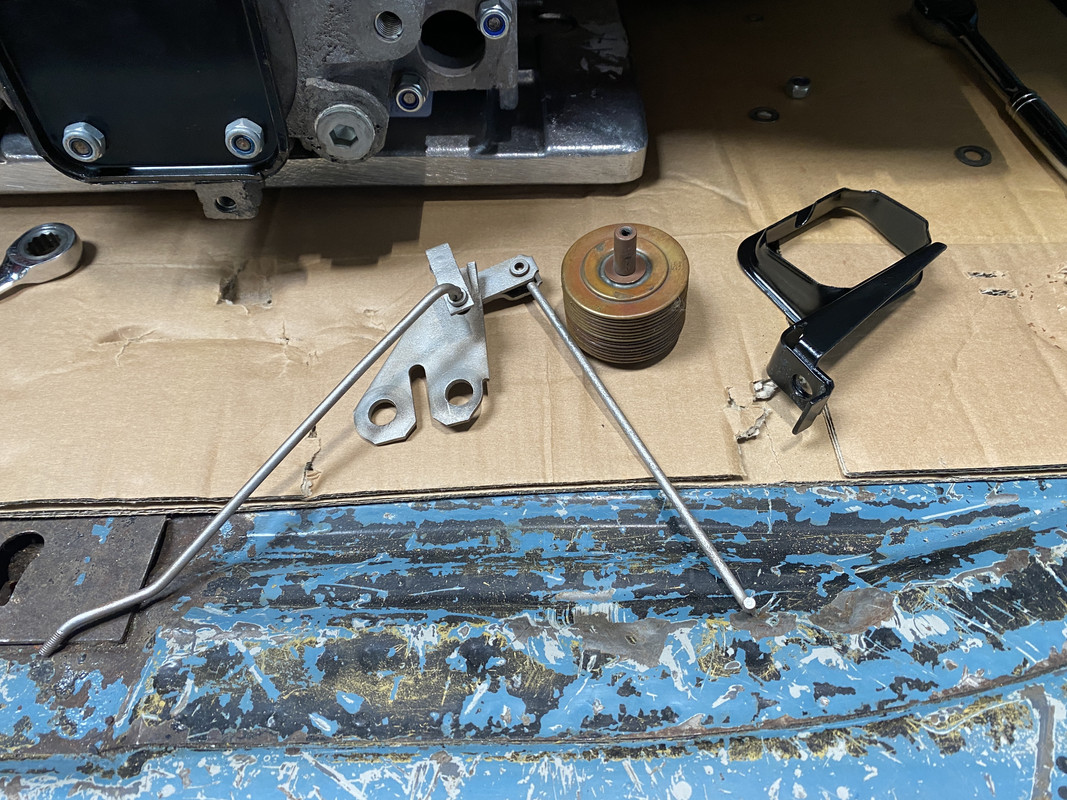

Back at the lockup today, ready to fit the newly cleaned and painted thermostat, bracket and flap linkage.
Hmm, that doesn't look right.
The rod won't go through the smaller of the holes in the head.
Looks like I'll be running without a thermostat after all that mucking about trying to source a linkage.

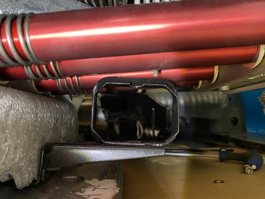

Mocked up the tinware, inlet and heat exchanger.
Now the fixing tabs on the heat exchanger don't line up with the tinware holes.

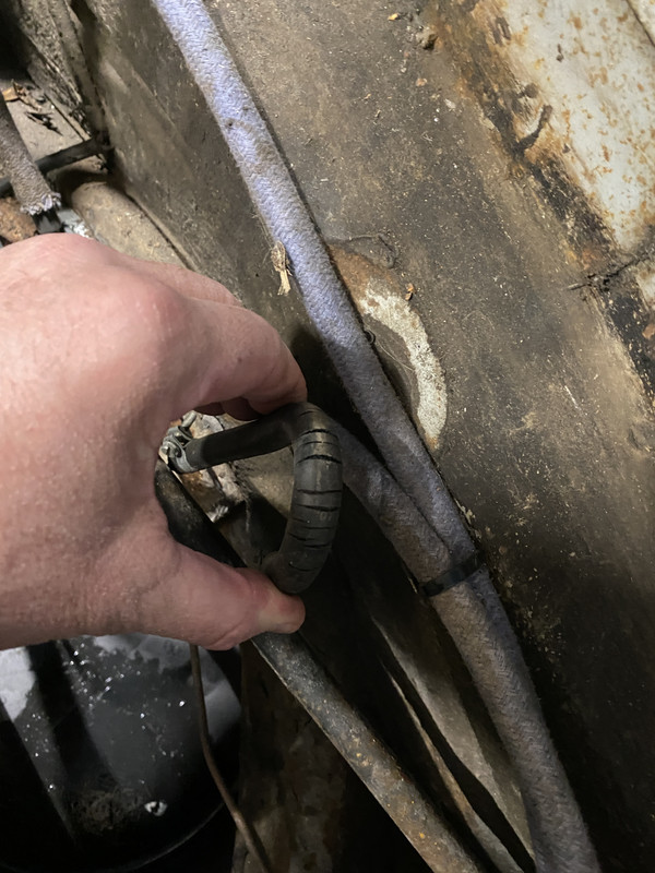

Managed to snap the metal fuel hard line where it goes into the front of the tunnel, it must have been weakened and I'd rather it break now in the lock up with no petrol around than somewhere miles away from home with a full tank.
So now the plan is to replace it with a new 8mm hard line that follows the brake pipe route through the car and AN-6 hose and fittings at the tank and in the engine bay.
